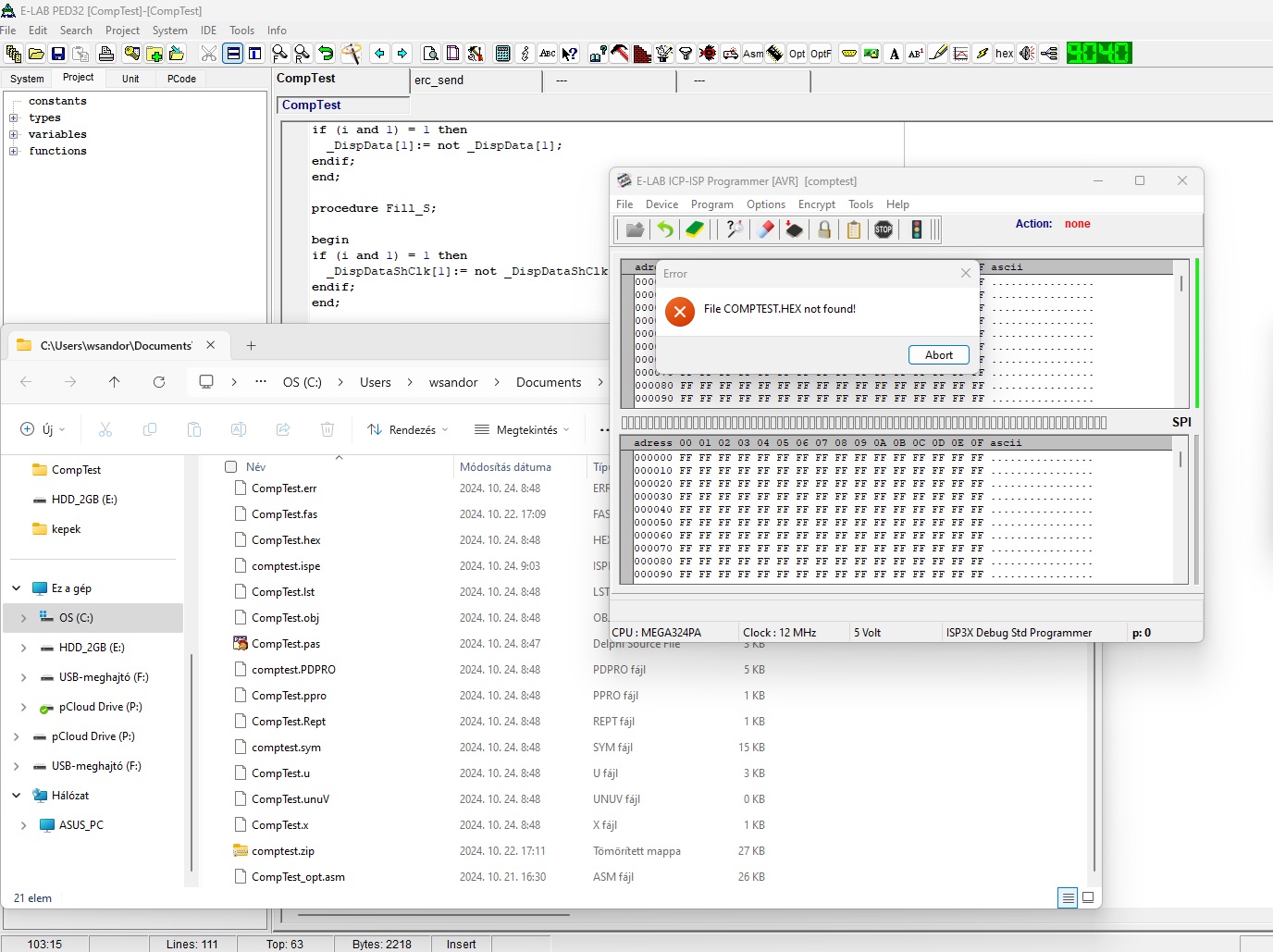

Unfortunately I run to a bigger problem: as you advised I reverted back to the original PED32 from PED32New, but I realised I can't program any projects from there. The Programmer always drop an error window that it doesn't find the project's hex file. I attached a screen capture from it. If I do the same from PED32New it works normally. Could you help me please, what could be the problem, because before the update everithing worked fine.
Sándor Wortmann
Bug in Optimizer at CompareBlock?
Dateiname: avrprog.jpg
Dateigröße: 356.63 KB
Heruntergeladen: 353
