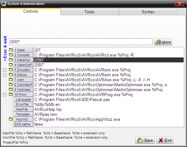

Optimizer compile time constants problem
Dateiname: system administration controls.png
Dateigröße: 33.3 KB
Heruntergeladen: 266
Re: Optimizer compile time constants problem
Gepostet: 09.06.2014 - 13:00 Uhr  ·  #7
Hi Avra.
Thanks for the sources. I can see what the problem is, but it is an issue with the compiler, not the optimiser. I have contacted you and Rolf via pm to explain the issue. Hopefully Rolf can resolve it for you.
