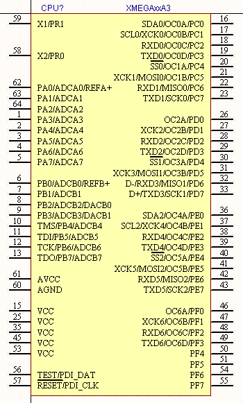

Hello all,
I have a little project which I'd like use to experiment with an XMega instead of "usual" megas.
But the first problem I found is the pin naming of the new CPU component I must define
in my schematic cad.
Respect to standard megas there are many Alternate Fuynctions on many pins
and it's not a problem; I'll draw a large component.
Because it's importat to me see the function of the pin I am connecting during schematic development.
But I have difficult to understand what are the exact functions on the pins and how these are enabled.
On Atmel datasheet I have seen only a table for "Alternate Pin Functions" but I do not understand the meaning of some columns, expecially for ADC and Timers.
Someone knows of datasheet or Appnotes which better explain the Alternate Pin Functions topic ?
Thank you,
Marco

Hello Marco,
the advantage of the XMegas is that they are all "port conpatible".
This means if a device has a PortE this PortE is always the same as
PortE with other devices. If there are alternate pin functions they
are always the same with all devices. But some exceptions still
exist. If a device has no USB then PortD 6+7 have no USB connection.
You have to read the main family datasheet thoroughly to get more
details.
Take a look onto my picture below. Here you can see most of the
standard port alternatives.
Xmega pin functions
Dateiname: XMega.png
Dateigröße: 10.6 KB
Heruntergeladen: 387

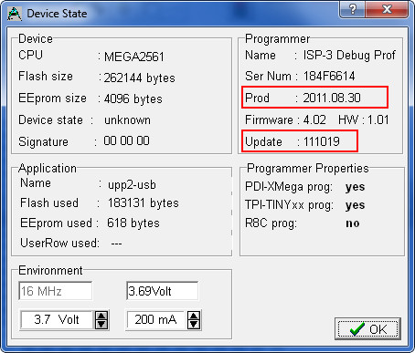

Gepostet: 11.10.2012 - 18:16 Uhr  ·  #4
Hello Marco,
yes, the other AVRs are not concerned. But please note that programmers
older than midth 2011 must be returned for a complete hardware and
software update.

Hi Rolf,
I don't remember the exact date I returned the programmer for upgrade...
There is a label with this number: 18580FBA [1.01]
Is there any ID on pcb to understand if it's an old version ?

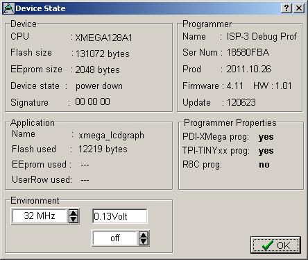

Marco
Re: Xmega pin functions
Gepostet: 12.10.2012 - 15:27 Uhr  ·  #6
Hello Marco,
run AVRprog.exe. Click the button with the loupe. The you can see some details. See below.
Xmega pin functions
Dateiname: ProgDate.JPG
Dateigröße: 56.65 KB
Heruntergeladen: 386
Gepostet: 12.10.2012 - 15:51 Uhr  ·  #7
Than you Rolf !
I am so used to see that page of AVRprog for device programming
that I completely removed the presence of other informations... :'(
So mine should be ok ?
Xmega pin functions
Dateiname: AVR Prog version.JPG
Dateigröße: 34.99 KB
Heruntergeladen: 370
Gepostet: 12.10.2012 - 20:00 Uhr  ·  #8
Hello Marco,
this is ok. But maybe these two resistors must be removed propably...
