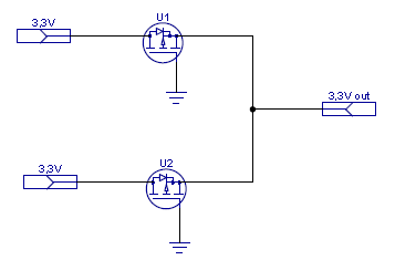

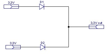

I am losing my time on a field, that I do not know – MOSFET. Namely, in a design, I have two possible sources of voltage – it can be active any of them or both with max 150mA. Till now I was on 5V and to have two diodes BAT754 it was not so big drop in percentage.
Now I switched to 3,3V and every mV counts. On net I saw design with MOSFET as a low drop diode. Since I need two, I tried with IRF7754 with around 34mOhm ON resistance. Result? If I apply voltage on any of inputs, there is a short. :devil:
Do any have any idea where I made mistake or how to solve this other way? Tnx.

Dateiname: Version BAT754.bmp
Dateigröße: 180.87 KB
Titel: First version
Information: Version worked on 5V
Heruntergeladen: 152

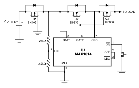

Idea from net
Dateiname: Idea from net.gif
Dateigröße: 5.53 KB
Titel: Idea from net
Information: MOSFET as low drop diode
Heruntergeladen: 319
Dateiname: Version MOSFET.bmp
Dateigröße: 246.07 KB
Titel: Version with MOSFET
Information: Don't work - short on power
Heruntergeladen: 155

found the reason - not in wrong usage of MOSFET. There was 3,3V zener which was solded in wrong direction. :'(
Now, there is no short on power lines but MOSFETS are not working as diode - if I apply power to one input, I have it also on other. :(
Looks like, I will switch to more expensive solution an add two LTC4411 - increasing component count but it should work. 8-)
