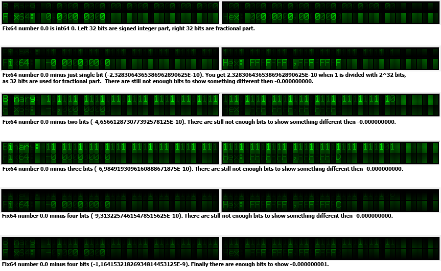

I think I owe everyone a little clarification. Replacing loop in Fix64 Demo1 with this code:
  fixNum := 0.0;
  loop
    LCDxy_M(LCD_m1, 0, 0);
    Write(LCDout_M, 'Binary: ' + IntToBin(fixNumOvr.w[3]) + IntToBin(fixNumOvr.w[2]));
    LCDxy_M(LCD_m1, 0, 1);
    Write(LCDout_M, 'Fix64:  ' + Fix64ToString(fixNum) + '   ');
    LCDxy_M(LCD_m2, 0, 0);
    Write(LCDout_M, IntToBin(fixNumOvr.w[1]) + IntToBin(fixNumOvr.w[0]));
    LCDxy_M(LCD_m2, 0, 1);
    Write(LCDout_M, 'Hex: ' + LongToHex(fixNumOvr.i) + DecimalSep + LongToHex(fixNumOvr.f));
    Dec(fixNumOvr.i64); // decrement for just single bit - breakpoint should be put here
Should give you something like in the attached image. Everything is explained in the image. Please take a look. It is now clear why I convert only very, very small negative numbers (between -2.3283064365386962890625E-10 and 0.0) to zero. Only because of technical reasons - there is just a single bit between these two numbers so we have to decide what it will be, one or the other number.
If anyone is willing to test if the same bug exists in Delphi/Lazarus unit mentioned at http://forum.e-lab.de/topic.ph…x64&page=2, I am willing to correct it if needed.
