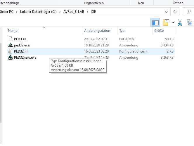

Good morning,
@Merlin, I've started AVRco several times, I get an error every time...\IDE\AVRpas.Ctrl would be missing.
Was the IDE directory always this empty?
Greeting Frank
Guten morgen,
@Merlin, ich habe schon öfters AVRco gestartet, mir wird jedesmal ein Fehler angezeigt ...\IDE\AVRpas.Ctrl würde fehlen.
War das IDE Verzeichnis immer so leer ?

Ah, it seems you have the answer Frank. This is the IDE directory which should have much more. I will update the 6.0.0 install to include the extra files.
In the meantime I attach some of the key missing files. If I am missing any more, please let me know.

Hello Marlin, now I can compile, but I still get an error AVRco.exe is missing.
Greeting Frank
Hallo Marlin, jetzt kann ich Kompilieren, aber es kommt noch ein Fehler AVRco.exe fehlt.

Hello Frank. I have just checked the install, and the files are there in the install. Did you do a full install?
Re: AVRco 6.0 Test
Gepostet: 16.06.2023 - 11:23 Uhr  ·  #13
You did not uninstall and then just install the update version did you?
Re: AVRco 6.0 Test
Gepostet: 16.06.2023 - 11:32 Uhr  ·  #14
'Hello Marlin, now I can compile, but I still get an error AVRco.exe is missing.' Yes that is probably because you are effectively using my CTL file. You will need to change the System Admin to point to the compiler and optimiser. My control file points to my development version (which obviously you will not have). Sorry about that. Here is correct version.

Hello Merlin, everything is ok now. I have no more problems.
If you have finished a new installation please let me know. Then I delete my complete and install the latest one again.
